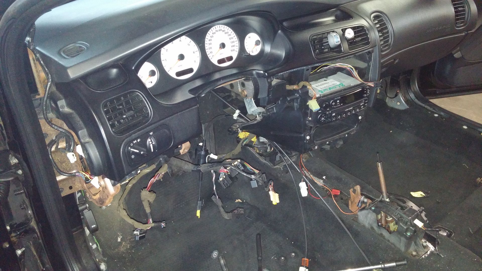

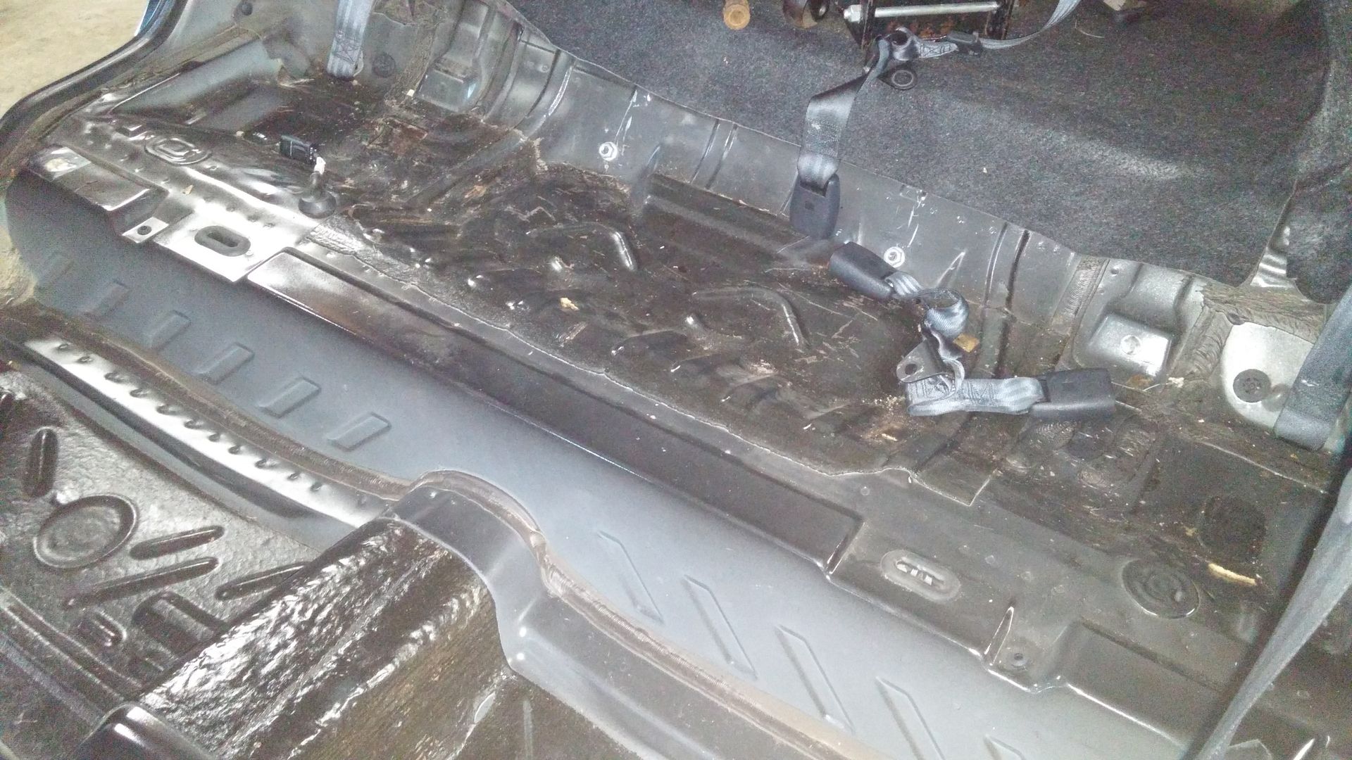

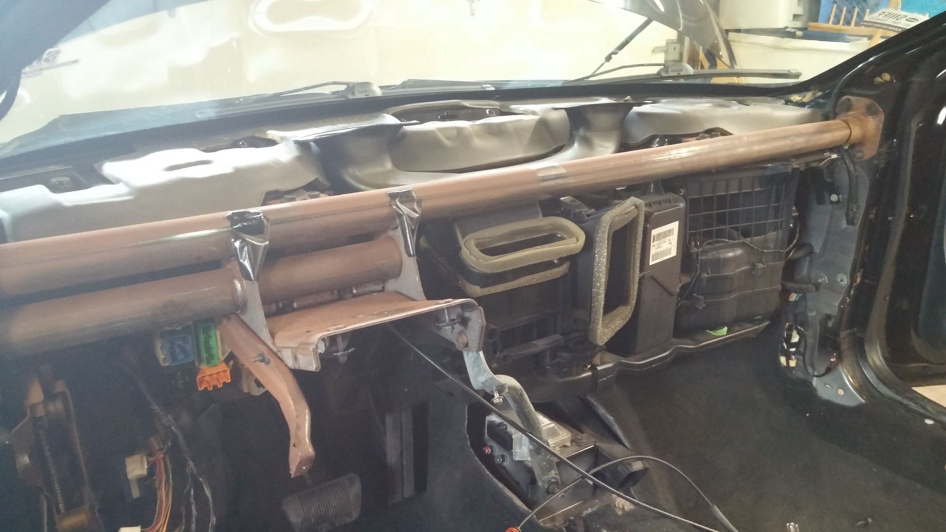

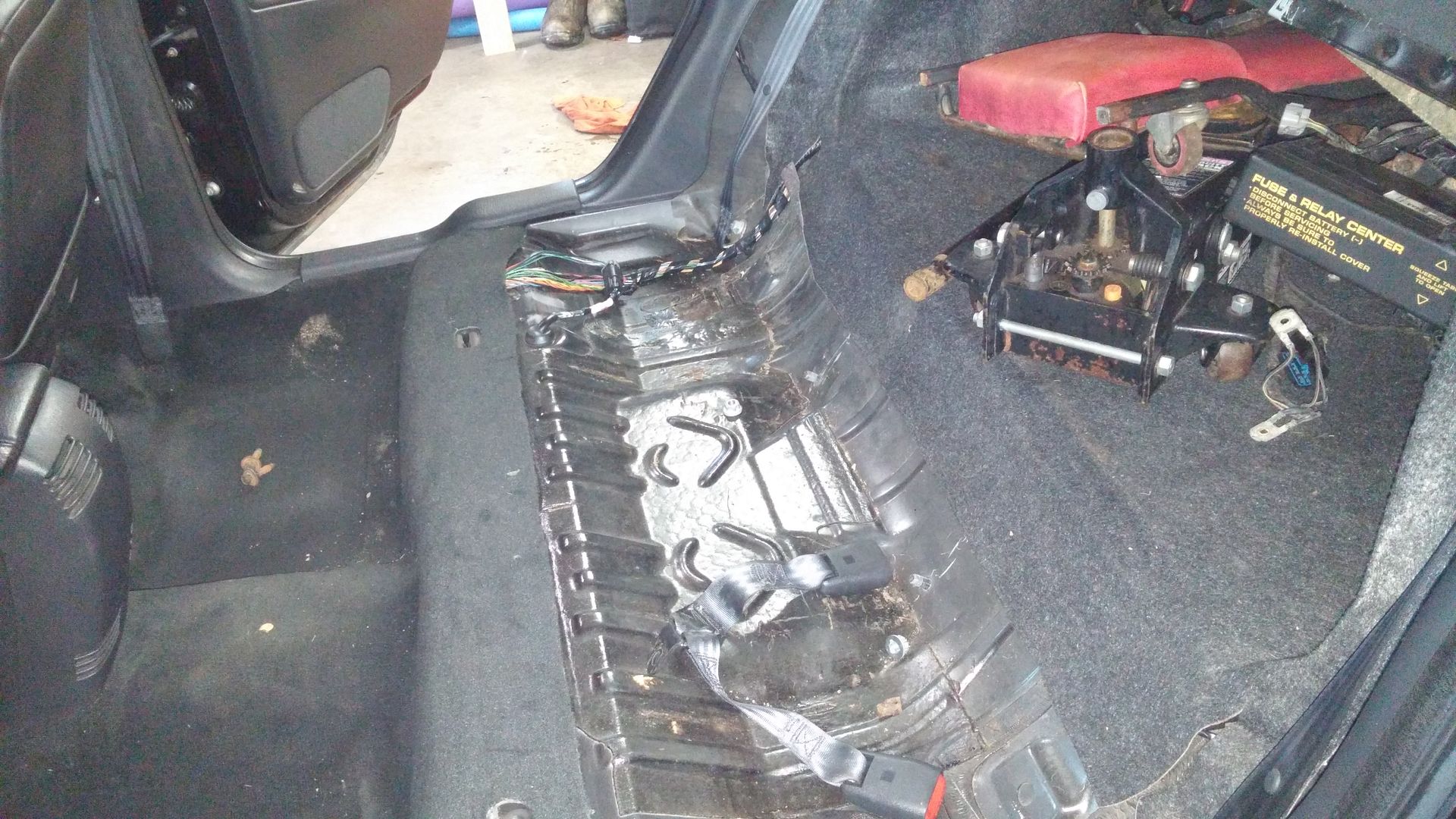

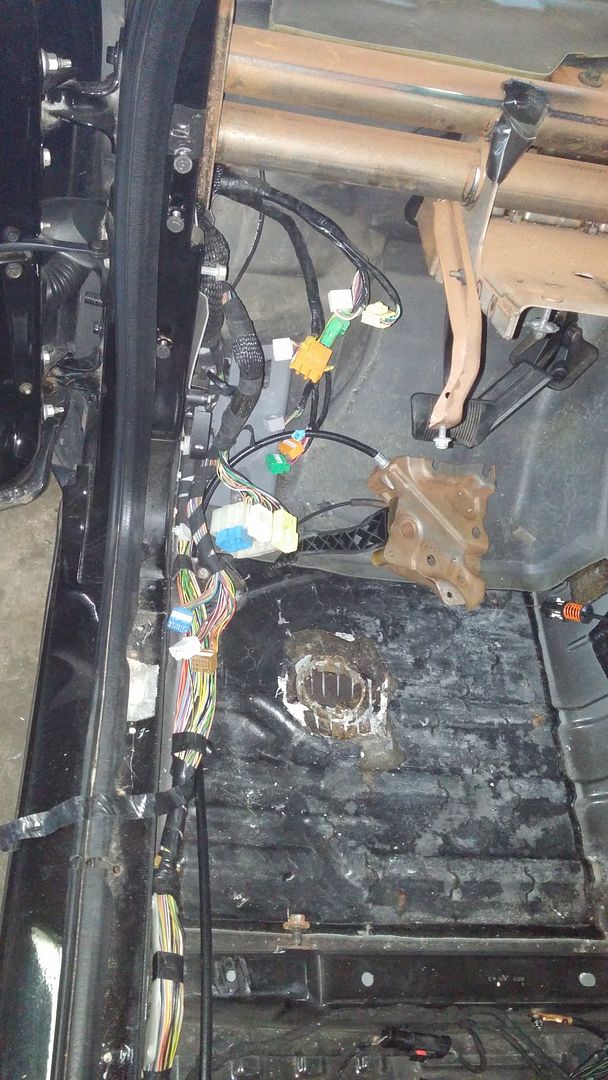

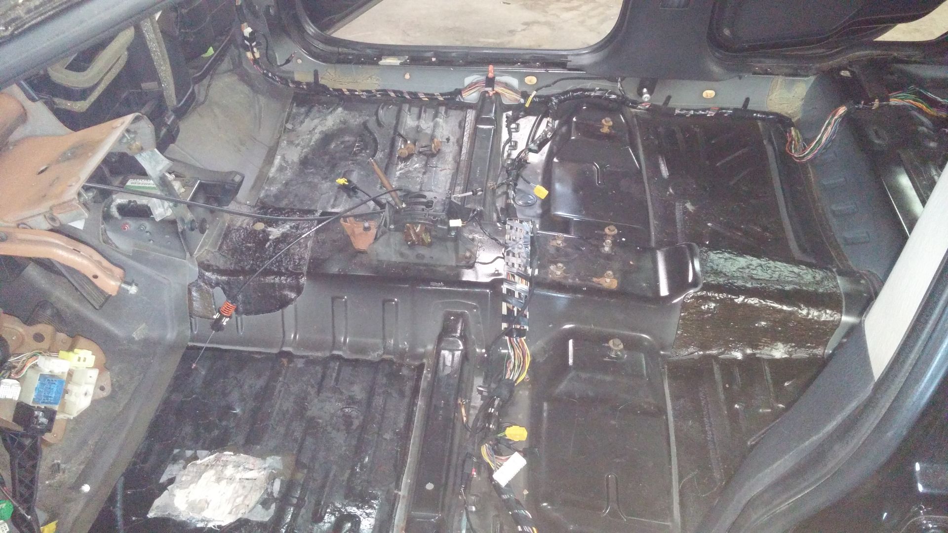

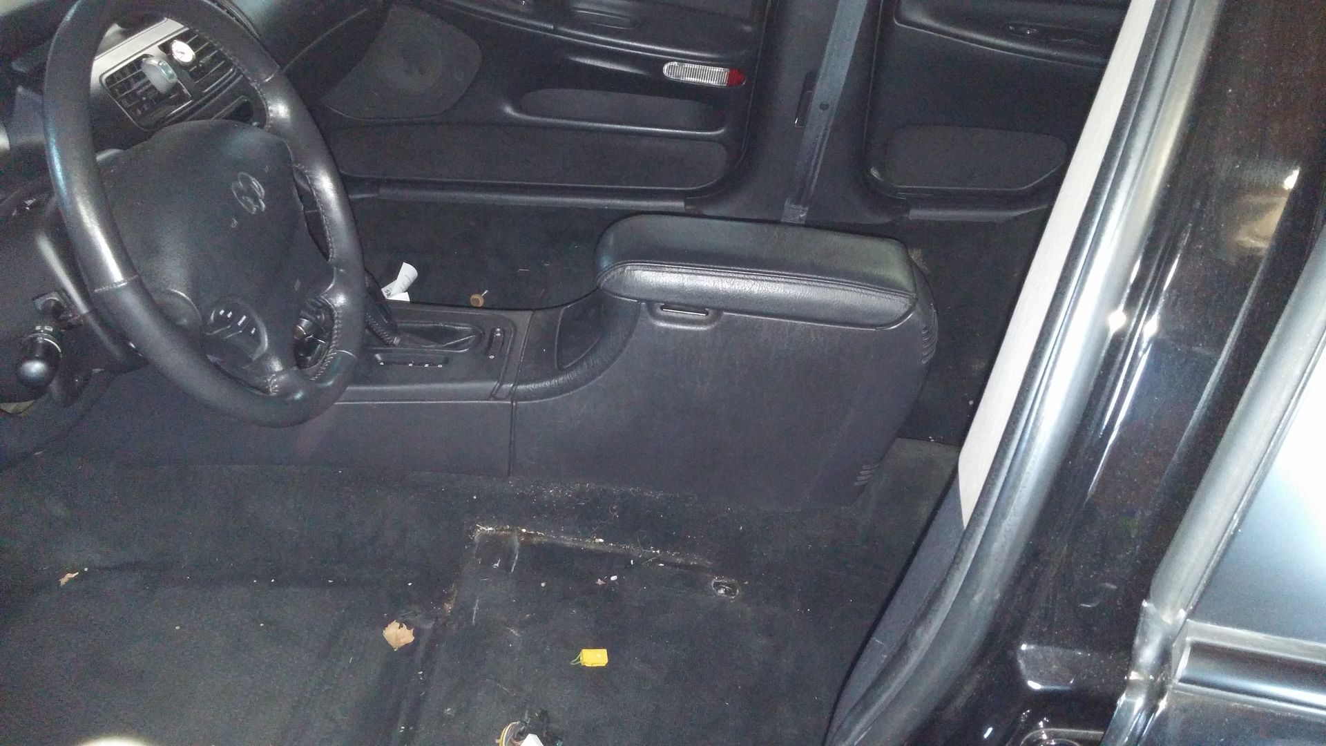

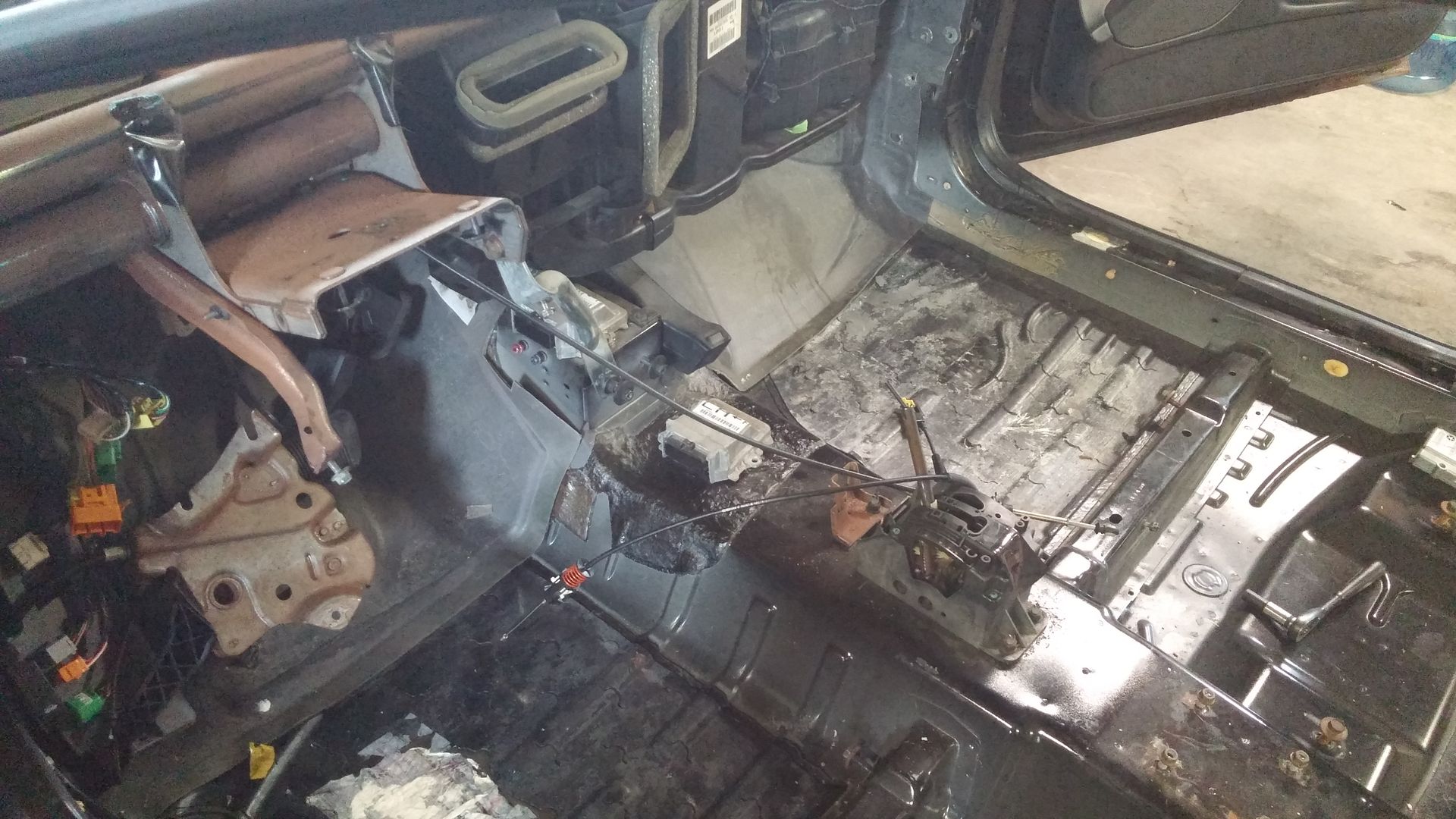

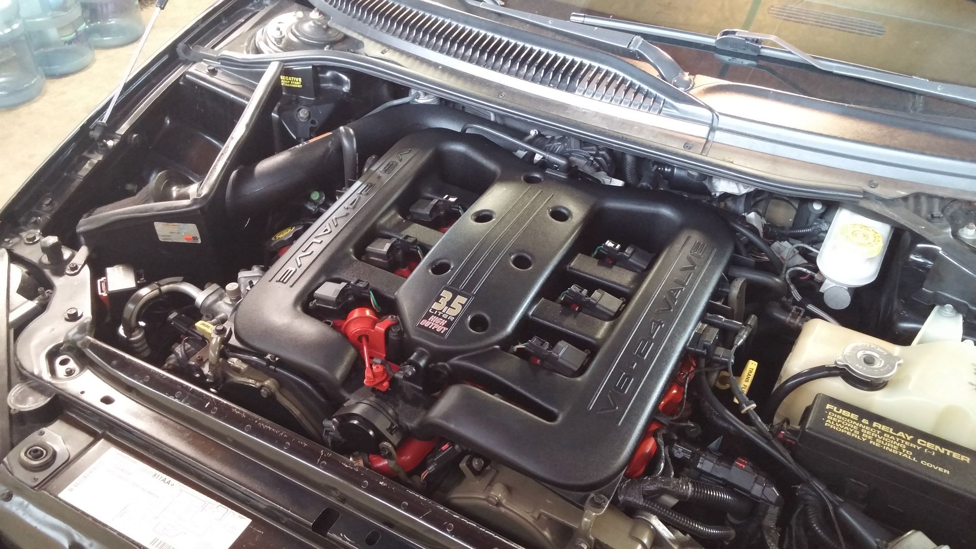

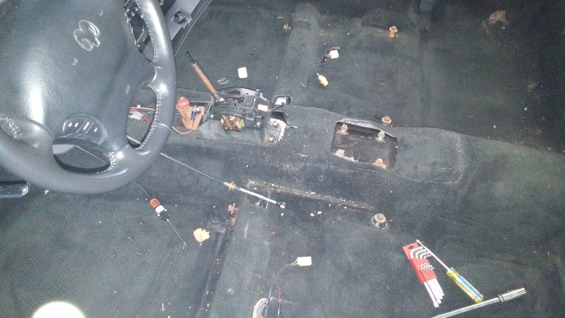

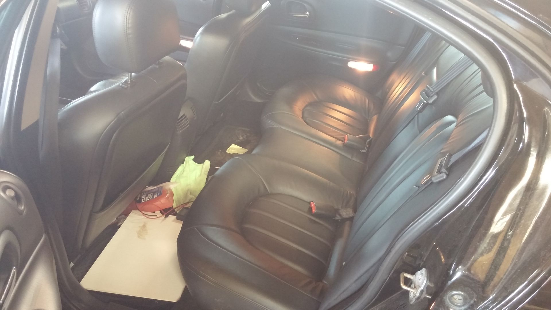

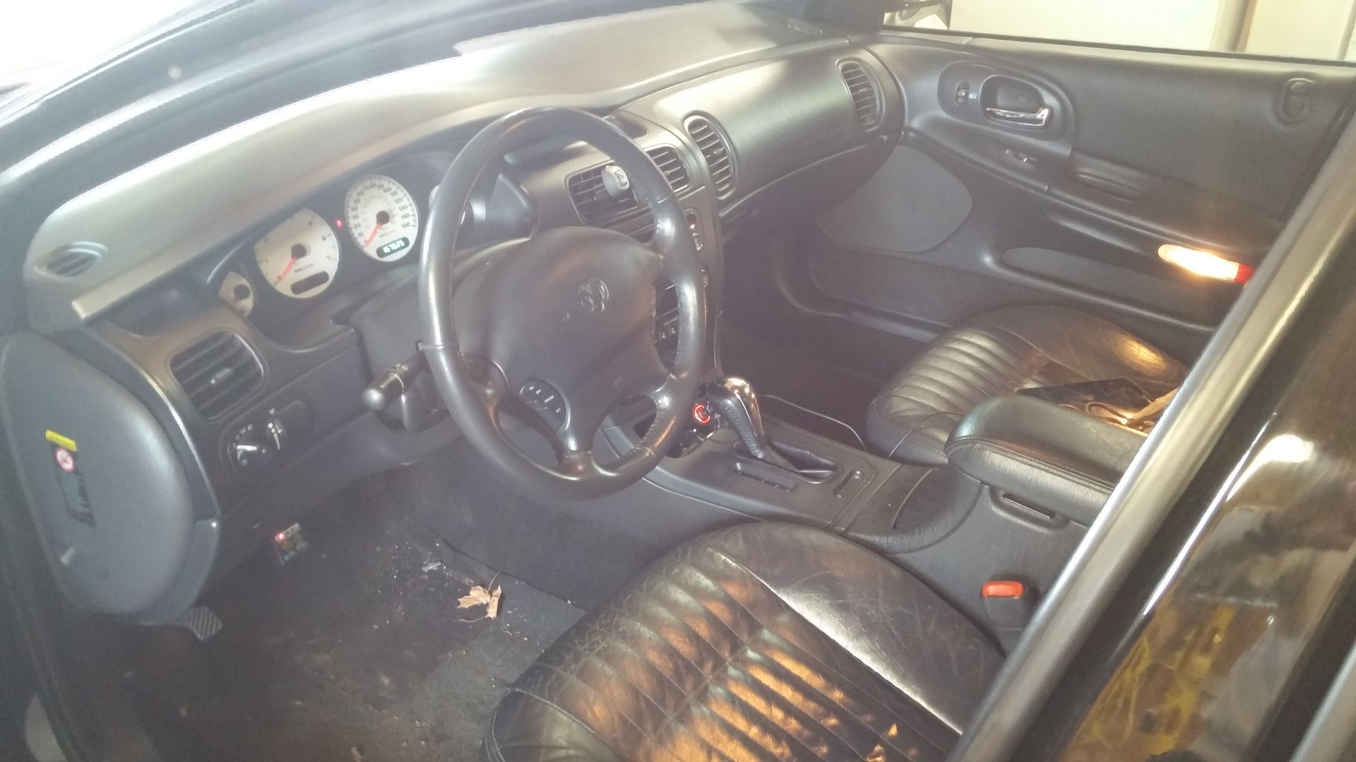

I've officially started the swap to '02 Special electronics.. Below are the pics.
Rear seat area
Front seat and dash
Engine compartment
Rear seat out
Front seats out
Console and heat duct out
Steering column out dash ready to be pulled
Dash out
Carpet out. I also found the source why my windows would fog up carpet on drivers side was wet.
Previously "repaired" plug that was leaking water during rain
Body harness out
'02 body harness being installed
This pic shows the body plug that needs repaired

mattgendron wrote:As an uninformed person, what does the change in electronics do?
I'm swapping everything over to '02 so I can use the '02 Special pcm Matt. Entr every wire needs to be changed.

Why didn't you put some sort of sound deadening in while you had everything out?
 #340736  by Strmvt
 December 22nd, 2014, 11:41 am
beespecial wrote:Why didn't you put some sort of sound deadening in while you had everything out?
Lol I'm at the store now buying just that mate. Got to fix that body plug to.

Good luck, it's going to be a long journey! It'll be worth it in the end though, and not impossible. You can keep your door, roof, headlight and possibly the trunk harness, that's about it with these installs.
 #340743  by Strmvt
 December 22nd, 2014, 1:35 pm
Yea gotta change airbags to I think. Different connectors. Already have a dash bag not hard to get a wheel bag got to get the gas tank trans harness and lower dash harness yet and a plenum/ throttle body
